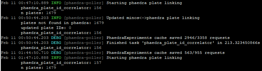

Here is a full command line that would only show log records during a specific minute
assemble-logs assemble logs/all.log '.ts > "2021-09-02T22:30" and .ts < "2021-09-02T22:31"'  | less -r
In the following we will only show the filter itself. Filter by (short) log level (CRIT, ERRO, WARN, INFO, DEBG, TRCE):
'.level == "WARN" or level == "ERRO"'
Tags can be very useful, especially if your application has several independent components, and perhaps even asynchronous periodic tasks - we have plenty, so we frequently want to follow a specific tag. To show only records with a specific tag:
'.tag == "phaedra-poller"'

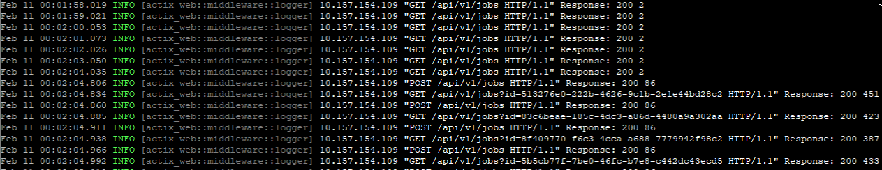

Everything actix-related (e.g. all incoming requests):
'.tag | startswith("actix")'
